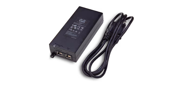

802.3at PoE Injector
  • Allows delivery of both data and power for the Meraki MV smart camera over a single Ethernet cable allowing for simple installation.
  • Input voltage: 100 – 240 AC, input current: 0.8 A maximum
  • AC input frequency: 50-60 Hz
  • Powered device can be up to 100 m away from power injector

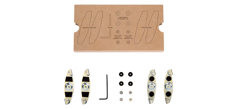

T-Rail Mount Kit
  • For mounting MV12, MV22, and MV32 cameras to recessed T-rail and flush T-rail-type celings.
  • Includes a pair of deep-drop ceiling clips and a spare T-rail adapter

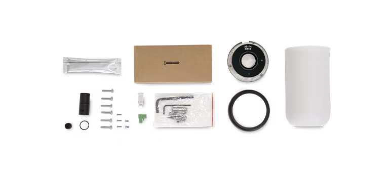

Replacement Kit for MV52
  • This replacement kit for the MV52 bullet camera includes a protective shield, lens cover, desiccant pack, and mounting hardware.
  • Dimensions: 174 mm (L) x 67.8 mm (W) x 98.6 mm (H)
  • Weight: .33 kg
