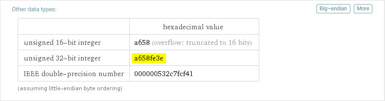

Determining the DHCP Transaction ID From the DHCP Req ID
The provided DHCP Req ID is for tracking in dashboard but cannot be used while trying to track DHCP information inside of Wireshark. In order to determine the corresponding DHCP transaction ID, follow these steps.
- Copy the DHCP Req ID
- Convert the Req ID to hex using this tool. Type the Req ID into the search bar using the following format
- Once the results are displayed, scroll down to the Other data types section. The transaction ID which can be used in Wireshark is available as the 'unsigned 32-bit integer' value.
NOTE: The DHCP Transaction ID is displayed in Wireshark assuming little-endian byte ordering format.
- The transaction ID can be used in conjunction with Wireshark to find the specific transaction by using the following filter. Simply prepend 0x to the beginning of the copied value and use the following filter in Wireshark.
bootp.id==
