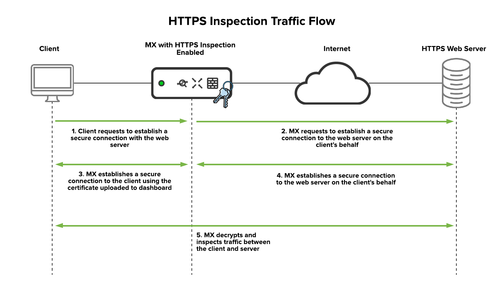

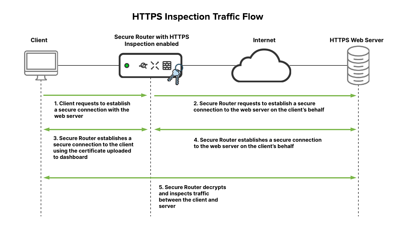

Inspection Traffic Flow
Without HTTPS inspection, a client typically establishes a secure connection directly to the intended server. With HTTPS inspection enabled, the security appliance proxies the requests from clients to establish an HTTPS connection on TCP port 443. When a request is seen, the security appliance responds to the client’s request on behalf of the server and establishes an HTTPS session directly to the client. While this is happening, the security appliance also establishes an HTTPS session with the client’s intended server.
When the security appliance has secure connections to the client and server, traffic between the client and server can be intercepted by the Secure Router, decrypted and inspected.

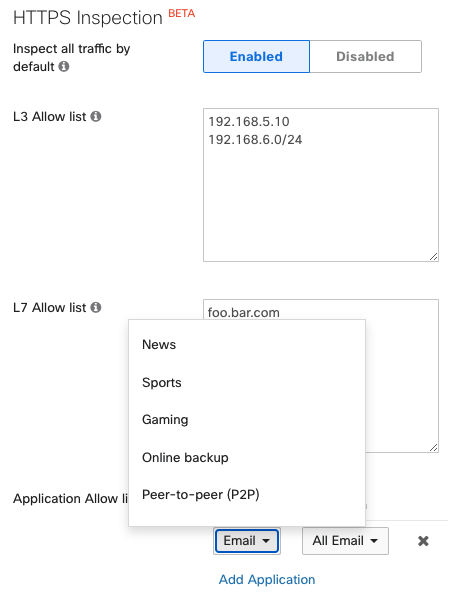

Configure Allow Lists
The L3, L7, and application allow list configurations apply to all clients affected by HTTPS inspection, including those with inspection applied via group policy.
Allow lists exempt traffic from inspection when required.
Navigate to Security & SD-WAN > Threat Protection. There are several options:
Configure Trusted Traffic Exclusions see more information on this feature here. This is applied org-wide. While the other options below are network specific.
Configure L3 allow list entries for source IP addresses that should bypass inspection.
Configure L7 allow list entries for destination hostnames that should bypass inspection. Wildcards can be used, for example '*.example.com' will match www.example.com.
Configure Application allow list entries for applications that should bypass inspection.
