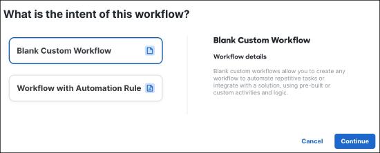

  5. Choose a type according to the intent of this workflow, and click Continue. For more information, see the Workflow Intent Help topic.

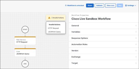

  9. When you have completed constructing the workflow, click Validate to verify that the workflow is valid.
    If you have invalid activities, they will be displayed with an orange bar, and a warning will be displayed in the upper right corner of the Properties panel.
    Resolve any issues and validate the workflow again.
