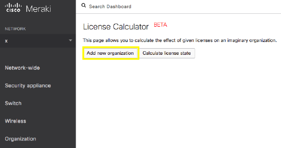

Setting Up the Calculator
The following steps explain how to simulate your organization's licensing in the license calculator:

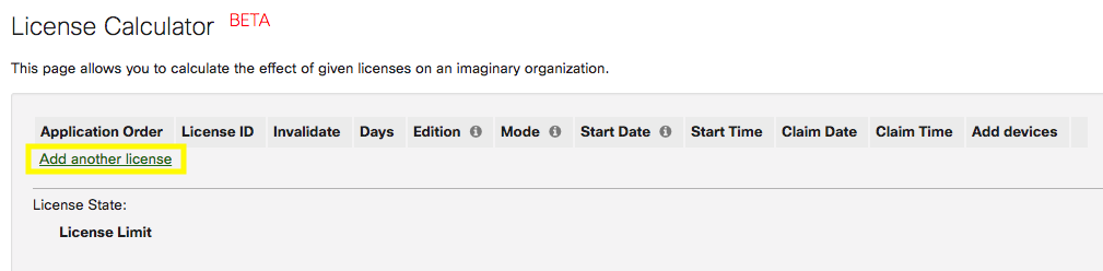

  1. Open the License Calculator.
  2. Click Add another license. Each license in your organization should be added in order, from old to new. Your licenses can be found in Dashboard under Organization > License info.
    Reference the Field Legend below for more information on each field in the calculator.
  3. Select Calculate License State to verify that the calculator’s co-termination date matches the expiration date shown in Dashboard.
  4. From here, add in any additional licenses to see the projected co-termination date.
