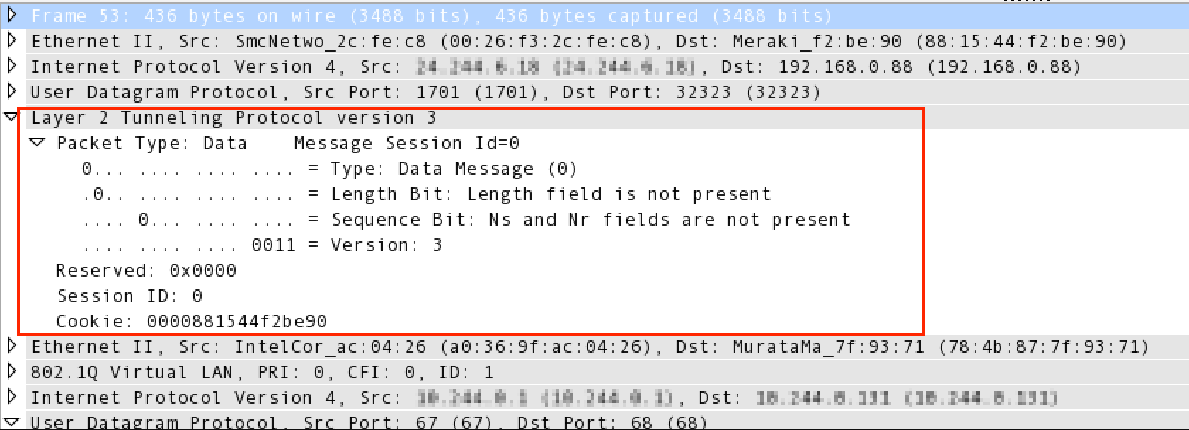

Decoding L2TPv3 Headers in Wireshark
If you'd like to check for L2TPv3 headers in Wireshark, you will need to configure Wireshark to decode the L2TPv3 header (supported on V.1.12, newer versions require right-clicking on the packet and selecting "decode as" ethernet). See below:
Once you can decode the frame, you will see the L2TPv3 header:
