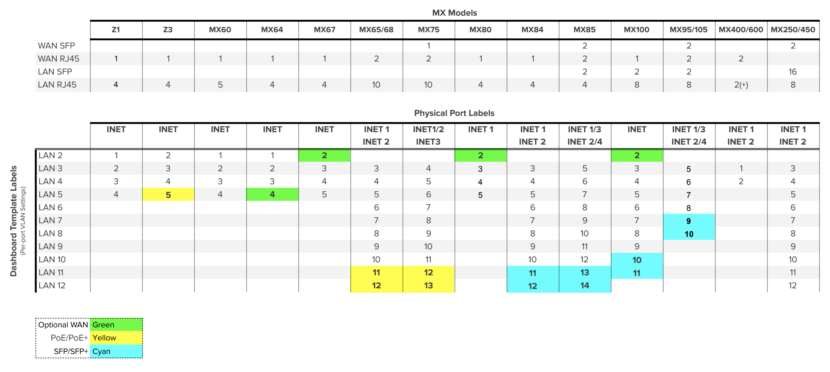

Port mapping between MX models
Refer to the port mapping table to see which ports map to which other ports across different MX models. The top section outlines the port count and type total. The second section maps the physical port labels to their representation on Dashboard. Use the mapping to calculate the offset between physical port labels and Dashboard configurations.
For example, the MX85's first LAN port is physically labeled "5" but maps to LAN 3 on Dashboard templates. For more information on template management, refer to Managing Multiple Networks with Configuration Templates and MX Templates Best Practices
Table for port mappings with all different MX models
