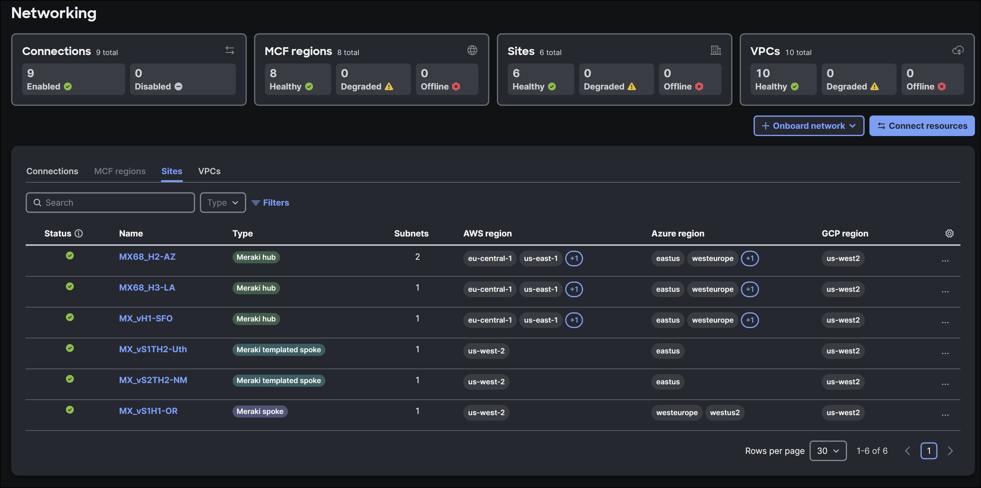

clipboard_e31b19b3a2d7600c3f5a458294471c515.pngSite
Site status
Site Status is a customer-visible classification of Site onboarding, offboarding, and connectivity health. It follows the common precedence defined above.
Connectivity-derived Site Status begins after every Regional Attachment in the Site's initial scope is Provisioned, whether MCF created them through Site onboarding or Automatic Hub Management. It aggregates the current Connectivity Status and BGP Status of those Regional Attachments.
For an already onboarded hub Site, a Regional Attachment added by Automatic Hub Management is excluded from Site Status while its state is Provisioning and included after its state becomes Provisioned. Automatic provisioning does not produce Site Status Onboarding in progress because no Site onboarding action occurred.
Site status Condition
Not onboarded The Site has no Regional Attachments, and no active or unresolved onboarding or offboarding operation applies.
Onboarding in progress Site onboarding has been committed, at least one Regional Attachment in its committed scope is Provisioning, and no unresolved onboarding failure exists.
Unknown Connectivity-derived Site Status applies, and every included Regional Attachment has both Connectivity Status and BGP Status Unknown.
Healthy Connectivity-derived Site Status applies, and at least one included Regional Attachment has both Connectivity Status and BGP Status Healthy.
Degraded Connectivity-derived Site Status applies, and the conditions for Unknown, Healthy, and Offline do not apply.
Pending removal Site offboarding has been committed, at least one Regional Attachment is Deprovisioning, and no unresolved offboarding failure exists.
Offline An unresolved Site onboarding or offboarding failure exists, or connectivity-derived Site Status applies and every included Regional Attachment has both Connectivity Status and BGP Status Offline.
