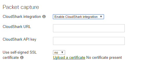

  1. In Dashboard, navigate to Network-wide > Configure > General.
  2. Under the Packet capture section, set CloudShark integration to Enable CloudShark integration.
  3. Enter the following information from CloudShark:
  • CloudShark URL: Enter the hostname as gathered from CloudShark. Unless you are using an enterprise CloudShark account, this will always be https://www.cloudshark.org.
  • CloudShark API key: Enter the API key as gathered from CloudShark.
  • Use self-signed SSL certificate: If you are using a dedicated CloudShark appliance and have opted to use a self-signed certificate for SSL, set this option to yes and click Upload a certificate to upload the self-signed certificate.
Enabling Cloudshark integration on the Dashboard
4. Click Save Changes.
