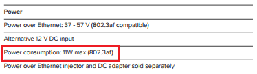

1 BTU/hr translates to 0.293071 Watts. Similarly, 3.412141633 BTUs/hr = 1 Watt. Using the Watt value found from the data sheet and following the formula (3.412141633 BTU/hr x (Watts) we can quickly find the BTU/hr consumption of any Cisco Meraki device. For example, the MR33 draws a maximum of 11W as specified by the datasheet.
Figure 1. Power consumption from MR33 datasheet.
Power consumption for MR33
Multiplying 11W x 3.412141633 will provide the BTU/hr value of 37.53 BTU/hr.
