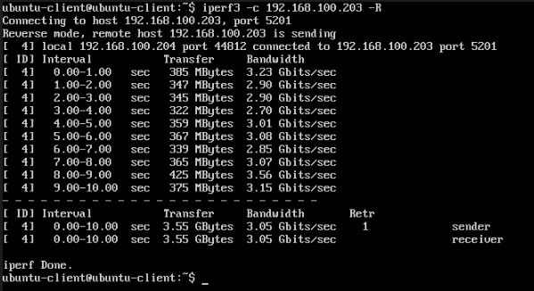

Linux
Client:
Screenshot of iperf client on linux

The following options can be run on the client side to change the type of data sent:
To measure bandwidth in both directions, use option -R, for example:
  • iperf3 -c 10.0.0.105 -R
