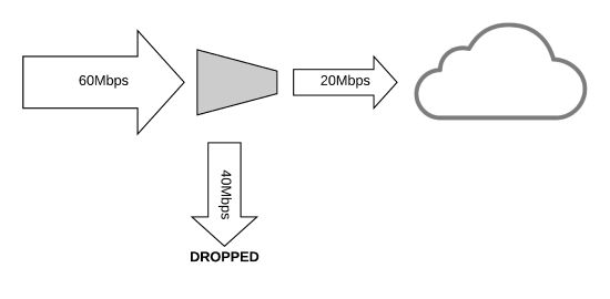

Link Congestion (Too Much Traffic)
This occurs when more traffic is attempting to go over a network link than it can support, such as 60 Mbps of traffic passing over the same 20 Mbps link. This creates a bottleneck, resulting in some traffic being dropped.
There are multiple ways to solve this, including:
- Increasing the capacity of the link being overwhelmed to allow for all traffic
- Apply traffic-shaping rules on MX security appliances or MR access points to limit the volume of traffic, particularly focusing on decreasing the volume of undesirable traffic
- Apply traffic-shaping rules on MX security appliances or MR access points to prioritize more important traffic
