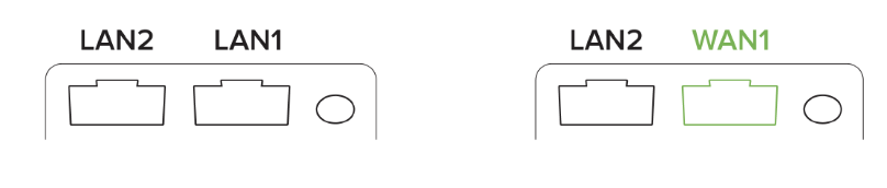

The Wired WAN Mode/ safe mode configuration is primarily intended for getting the MG devices online via a wired connection when it falls offline from an active cellular connection for troubleshooting by Meraki support. Safemode/WWM allows for additional troubleshooting if a valid working cellular is unavailable. MG cellular gateways can be configured to have port 1 as a WAN uplink. When in WWM/safe mode mode, port 1 is converted into a WAN port to allow connection into a switch, router, or an ISP. Similar to an MR access point, when plugged into a switch device it will attempt to obtain a valid IP and reach out to the dashboard. When there is a valid wired network connection on port 1, the wired interface will take priority over the cellular interface even if the cellular interface is functioning properly.

The right graphic highlights the port 1 configuration in the role as a WAN1 interface when enabling Wired Wan Mode.
