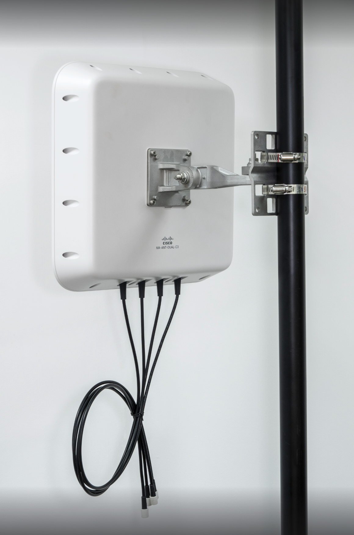

The Cellular Patch Antenna (MA-ANT-DUAL-C3) is ideal for situations that require higher directional gain towards a cellular tower. When mounted high up on a pole for a clearer line of site toward a cellular tower, the MG cellular gateway will have higher signal quality and power. The patch antenna can be used to help increase signal strength if the dipole antennas are not giving you a signal quality you need. This antenna can help boost coverage due to its unique cone shape coverage pattern when pointed towards the correct cellular tower for your preferred carrier.
Antenna Profile
Top View Bottom View Left side view Right side view
Front side Back side
Specifications
| Category | Specifications |
| Ordering Information |
MA-ANT-DUAL-C3 (Please use this SKU name when ordering patch antenna set) |
| Dimensions | 350mm x 350mm x 77.6mm |
| Type | Sub6 4x4 full band directional antenna |
| Connector | RP SMA PLUG 4x4 |
| Cable | NFC-200 L:36 Inch |

Install Guide
Wall Mounting
Pole Mounting
