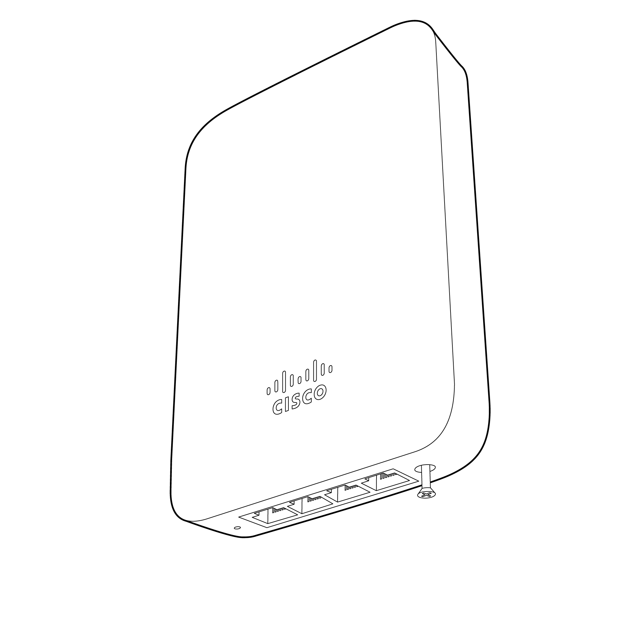

The Cisco Meraki MR36H is a dual-band 802.11ax cloud-managed access point with integrated Ethernet ports. Designed for room wireless and wired connectivity, the MR36H is easy to install on the wall on a single gang box, and is the first cloud managed hospitality AP.

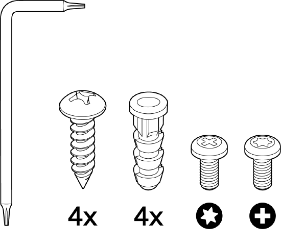

Mount Kit Edit section
Eject/Security Screw Tool, Wall Screws (Phillips), Wall Screw Anchors, Torx Security Screw, Phillips Security Screw

Mounting Compatibility
MR36H fits perfectly on the MA-MNT-MR-H2, Meraki Surface Mounting Kit.
If retrofitting mount of MR30H to MR36H is necessary, meaning the old mounting brackets will be used for MR36H, or the mounting plate included with the MR30H (MA-MNT-MR-H1A) which is directly mounted to an electrical box would be used, then there is a  two to four screws to be removed and replaced.
The same mounting plate that fits MR30H could be used If the use of the MR36H's passthrough port is not needed, as that is the part that will be covered by the old bracket.
*Old Mounting plate that included with the MR30H (MA-MNT-MR-H1) is not compatible with MR36H

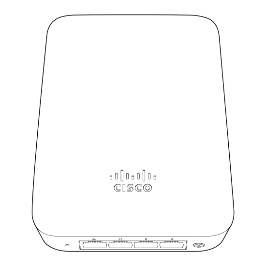

Ethernet Ports  Edit section
Uplink Edit section
The MR36H features a Gigabit Ethernet RJ45 port that accepts 802.3at and 802.3af power on the rear of the unit. This port should be used for uplink to your WAN connection.
LAN Access Ports Edit section
The MR36H features 3x LAN ports labeled 1 through 3. Port 1 may provide 802.3af out to an end device if the MR36H is powered via a 802.3at power source. Configuration details can be found in the AP port profiles article.
The LAN ports on an MR36H behave like access ports on a switch, and will not accept incoming traffic if it has a VLAN (802.1q) tag applied.
Connecting another MR to the LAN ports of the MR36H is not a supported topology.

T8 Torx Screwdriver, Phillips screwdriver, Hammer, Drill with 1/4" (6.3mm) bits
