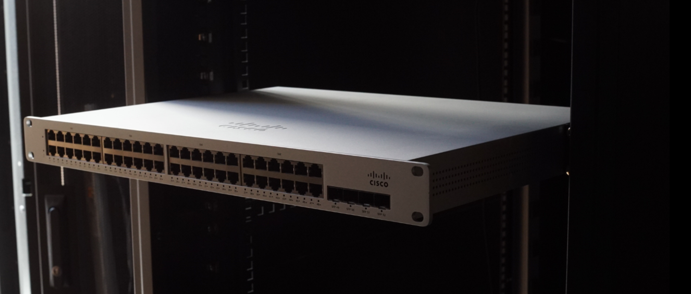

Meraki sells Mid-Mount mounting brackets which enable certain switch models to be mounted father forward in the rack, which may be helpful for shallow switch racks, or racks that mount switches on both sides with their rear sides facing each other.
Compatible Switch Models
MS120/125 (except the 8-port models), MS130 (except the 8-port and 12-port models), and MS210/225/250 models are compatible with mid-mount mounting brackets MA-MNT-MID-1.
Mounting
Installing switch using mid-mount mounting brackets
Brackets
MS switch brackets front/mid
Front View
Front view - mid-mounted switch
Rear View
Rear view - mid-mounted switch
