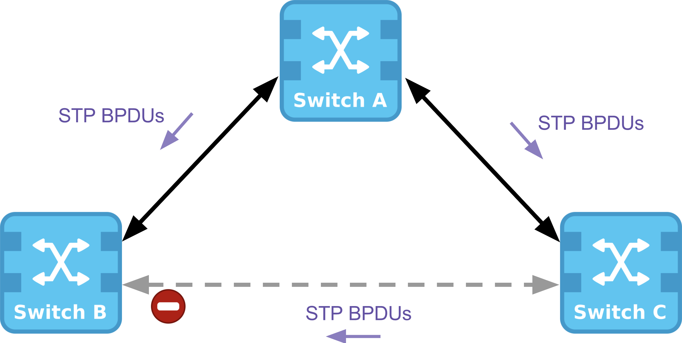

In the below example we have three interconnected switches with an extra redundant link. Switch A is the STP root bridge, the flow of BPDUs are denoted by purple arrows, and STP convergence results in Switch B placing its connection to C into a blocking state.
  1. This is our baseline topology.
baseline topology without udld
