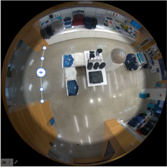

Line Crossing Configuration
The Line counts people crossing in each direction. When people cross the Line in the direction of the arrow, they are counted as "In". People moving in an opposite direction to the arrow are counted as "Out."
Each Line is a polyline with four adjustable vertices, allowing precise adjustments to fit the entry/exit point.
When applying a Line to a fisheye camera, the Line will automatically curve according to the mounting height configured for the camera to adjust for the specific fisheye lens characteristics. This makes it easier to fit a Line to physical spaces.

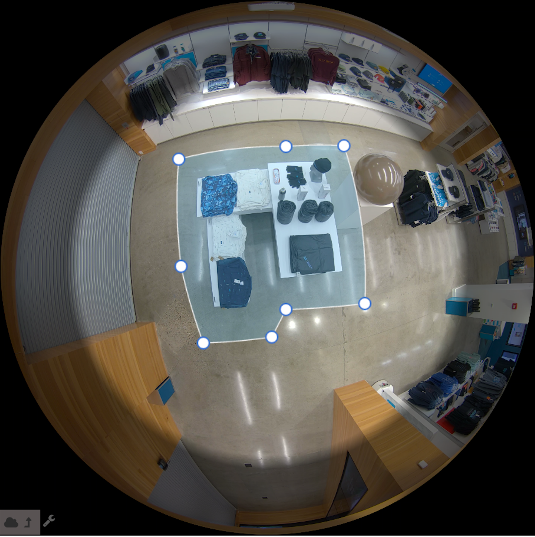

Area Occupancy Configuration
An Area is used to monitor occupancy within a region of interest for a particular location.
Each Area is a polygon with eight adjustable vertices, allowing precise adjustments to fit the region of interest.
When adding an Area to a fisheye camera, the Area will automatically curve according to the mounting height configured for the camera to adjust for the specific fisheye lens characteristics. This makes it easier to fit an Area to physical spaces.
Note that the calculated feet position is what matters, so the area should align with where people are standing — whether that's around an object (like the table in this example) or in a specific location (such as a waiting or queue area).
