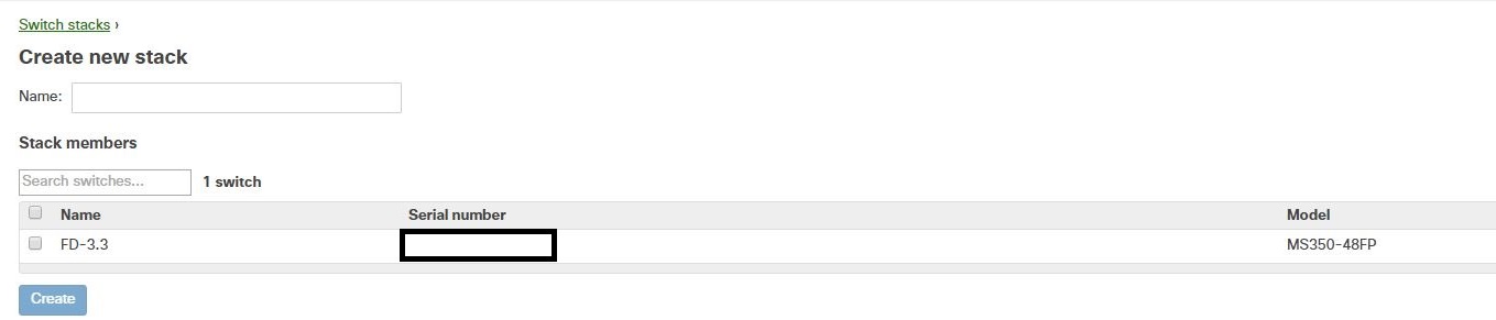

Navigate to Switching > Monitor > Switch stacks.
Configure the switch stack in the dashboard. If the dashboard has already detected the correct stack under Detected potential stacks, click Provision this stack to automatically configure the stack.
Otherwise, to configure the stack manually:
Click add one / Add a stack:
Select the checkboxes of the switches you would like to stack, name the stack, and then click Create.
The configuration is complete and the stack should be up and running.
