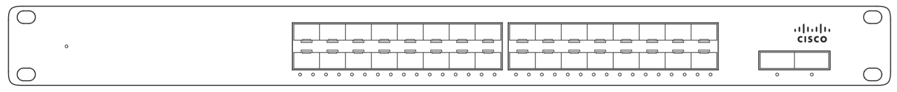

Front Panel
MS425-16 Series front panel
MS425-32 Series front panel
