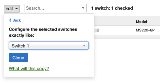

  1. Select Edit, then Clone...
MS edit clone in old version Dashboard
  1. Select the source switch that you want the target to match
MS clone select source in old version Dashboard
  1. Select Clone to copy configurations from the source to the targets

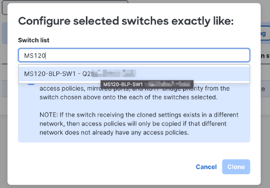

  1. Select Clone
Clone switch in New Dashboard
  1. Type the name of the source switch that you want targets to match, then select the switch from the results
Select source switch in New Dashboard
  1. Select Clone to copy configurations from the source to the target(s).
