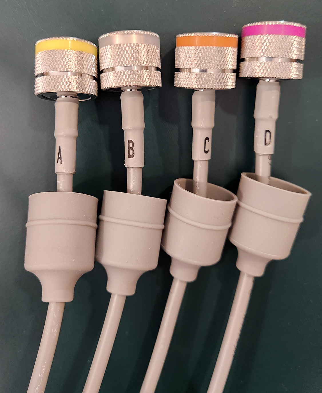

What is the correct way to cable the CW-ANT-D1-NS-00 patch antenna?

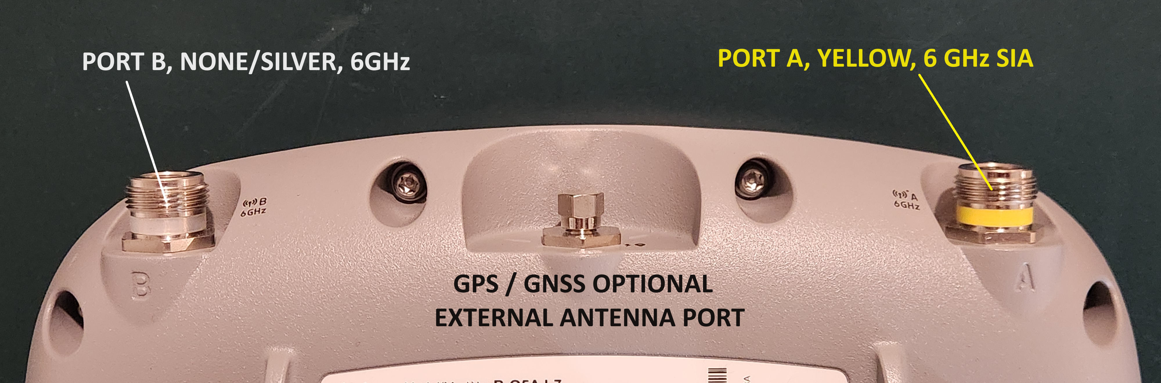

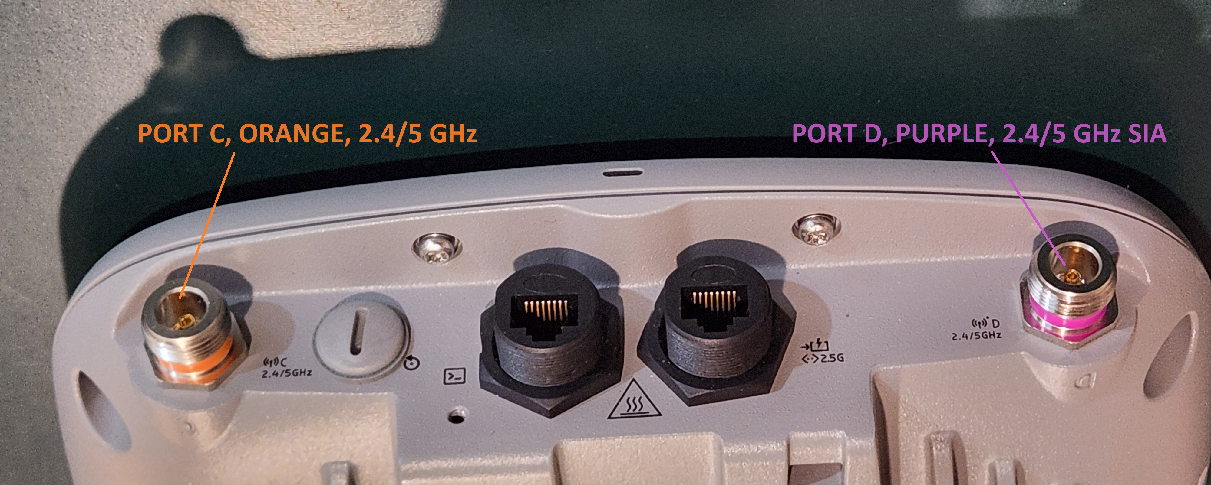

All four integrated antenna cables on the CW-ANT-D1-NS are color-coded to exactly match the four corresponding ports on the CW9163E access point.
Ports A and B are the 6GHz ports, port A is the SIA (Self-Identifying Antenna) port.
Ports C and D are the 2.4/5GHz ports, port D is the SIA port.
CW9163E has four corresponding N-connectors.  Two of them are 6GHz (Port A with the yellow band, Port B with no color band), and two of them are 2.4/5 GHz (Port C with the orange band, Port D with the purple band).
Tri-band Antenna port / cable color codes:
Yellow marker = 6 GHz SIA (Port A)
No color marker = 6 GHz non-SIA (Port B)  (might also be referred to as gray or silver marker)
Orange marker = Dual Band 2.4/5GHz non-SIA (Port C)
Purple marker = Dual Band 2.4/5GHz SIA (Port D)
Black marker = Tri-band SIA (black band on the omni antenna)

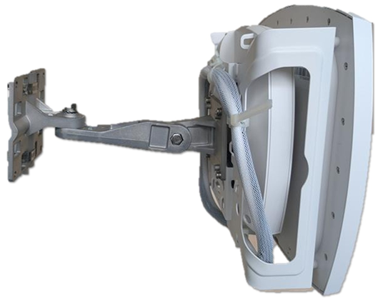

What are the Details Regarding the ART2 Articulating Arm Mount?
The CW-MNT-ART2-00 is for wall or pole mounting, and may be used with the CW9166-D1 or CW9176D1 APs or the CW-ANT-D1-NS-00 antenna.  This mount is also included when purchasing the tri-band directional patch antenna CW-ANT-T-D2-D8.  It has a 116x116 mm main frame mount that connects to a wall or pole, an 87x87 mm AP frame mount, and a 235 mm long mounting arm.
Note that with the CW-MNT-ART2-00, the extension arm is optional.  It is included with the mounting hardware, but may not be required depending on the type of installation.  Therefore it supports both single and dual-axis mounting options.  This gives rise to the "single pivot" (no extension arm) and "dual pivot" (with extension arm) types of mounting.  See the images below.
Without the extension arm, there is a single pivot point and this single axis allows for +/- 50° of adjustment (left image).
Using the extension arm, there are two pivot points allowing for +/- 60° of azimuth and +60° to -90°of elevation (right image).
Given there are both single or dual pivot installation types, this gives rise to two corresponding weights and measures (see below) when using this mount with the CW-ANT-D1-NS patch antenna.
CW-ANT-D1-NS antenna only: 1.92 pounds (30.76 oz, 0.872 kg)
CW-ANT-D1-NS antenna with single pivot (without extension arm) CW-MNT-ART2-00: 2.9 pounds (1.32kg)
CW-ANT-D1-NS antenna with dual pivot (with extension arm) CW-MNT-ART2-00: 3.3 pounds (1.5kg)
CW-ANT-D1-NS antenna only: 10.58 x 8.28 x 1.38" (268.8 mm x 210.2 mm x 35 mm)
CW-ANT-D1-NS antenna with CW-MNT-ART2-00 single pivot (without extension arm), fully extended: 10.58" X 8.28" X 5.5" (268.8 X 210.2 X 140 mm)
CW-ANT-D1-NS antenna with CW-MNT-ART2-00 dual pivot (with extension arm), fully extended: 10.58" X 8.28" X 10.63" (268.8 X 210.2 X 270 mm)

Also note there is an updated color convention that was released with the introduction of tri-band and self-identifying antennas.
No color marker = 6 GHz non-SIA  (might also be referred to as gray or silver marker)
This antenna connector pictured below with the black band indicates a tri-band SIA:

What are the Antenna Mounting Arm Options?
MA-MNT-ANT-1 Standard 8.7" mounting arm for E & F series patch antenna
MA-MNT-ANT-2 Long 13" mounting arm for E & F series patch antenna
MA-MNT-ANT-3 Horizontal mounting bracket for C & D series omni antenna
MA-MNT-ANT-4 Vertical mounting bracket for C & D series omni antenna
MA-MNT-ANT-5 Threaded Extension Arm for all surface-mount C/D/E/F Antennas
MA-MNT-ANT-6 Meraki Outdoor Antenna (21/23/25/27) Replacement Mounting Kit
CW-MNT-ART2-00 Replacement articulating arm mount for CW9166D1, CW9176D1, CW-ANT-D1-NS-00

Are there T-rail or universal mount adapters for Meraki APs?
Yes, you may order any of these SKUs separately:
  • MA-MNT-CLG-1  - Meraki T-Rail Channel Adapter Mount Kit
  • MA-UMNT-MR-A2 - Meraki MR Adaptor for Cisco Universal Mounts
  • MA-UMNT-MR-A3 - Meraki MR Adaptor for Aruba Universal Mounts
