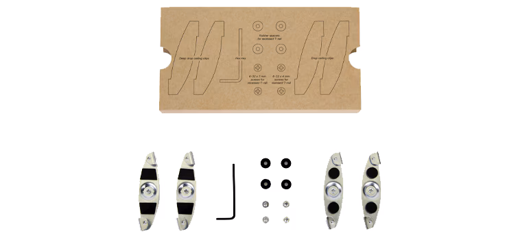

MA-MNT-CLG-1
This image shows the  MA-MNT-CLG-1 accessory.
T-rail Mount Kit
  • Includes two deep-drop ceiling clips and T-rail adapter for recessed T-rail and flush T-rail.
  • Compatible with all Meraki MR indoor APs and MV12 and MV32 cameras.
  • Deep-drop ceiling clip works well with “Armstrong silhouette” and similar ceiling grids

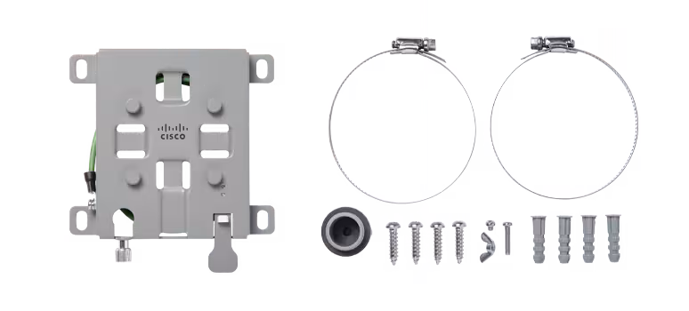

MA-MNT-MR-16
This image shows the MA-MNT-MR-16 accessories.
Mounting Kit for MR76, MR86, and CW9163E
  • This kit provides mounting accessories and hardware for Cisco Meraki MR76, MR86, and CW9163E access points.
  • Contains:
    • Replacement mount plate
    • Drop ceiling clips
    • Four wall screws and anchors
    • Grounding screws
    • Mounting straps
    • Cable gland
