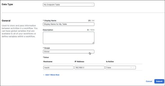

However, when you use a table type as a global variable, you must provide at least one row to create the variable.
Here is an example of a global variable that uses a custom table type with one row:
