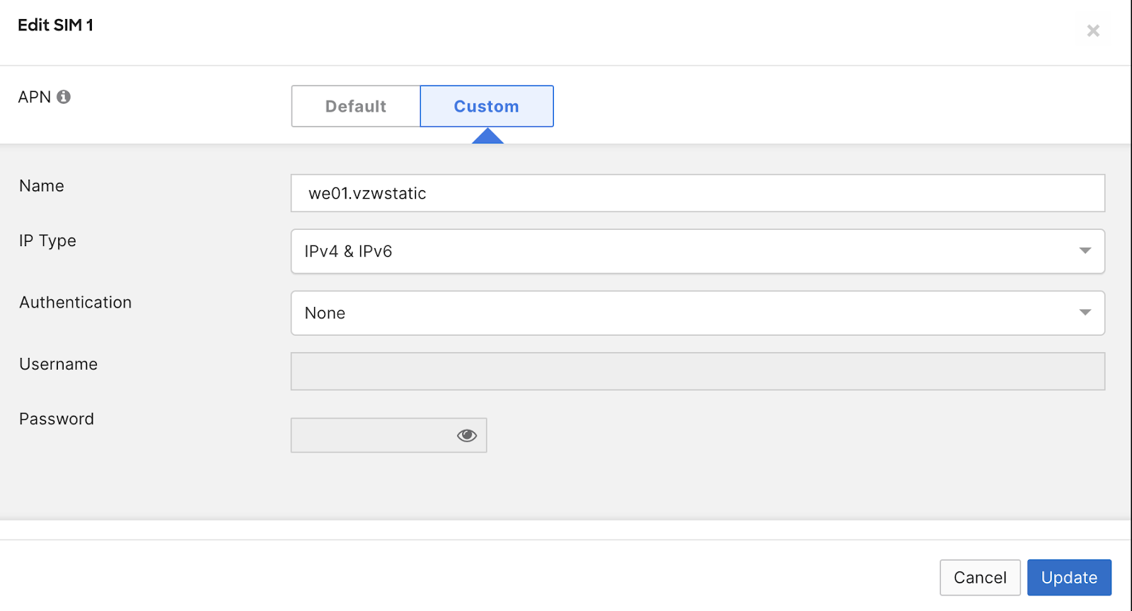

Via Dashboard
Click on the "Uplink" tab of the MG and scroll down to the "Configuration" section. Click on the "edit" button as shown:
The configurable fields are explained below:
- Name - This field is used to configure the APN provided by the carrier.
IP type - This field is used to specify the preferred IP type when connecting to the APN. The different options are IPv4, IPv6 and IPv4v6.
Authentication - Select the authentication method the MG uses to establish a successful connection, if needed. The different options are PAP (Password Authentication Protocol), CHAP (Challenge Handshake Authentication Protocol) and None.
Username - This field is used to specify the username when authentication is set to PAP or CHAP.
Password - This field is used to specify the password when authentication is set to PAP or CHAP.
Note: If incorrect information is entered for any or all of the parameters mentioned above, this will prevent a data session from establishing over the cellular network. As a result the MG will be unable to connect to the carrier's network.
