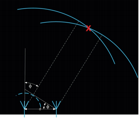

Beamforming
Beamforming occurs when an AP and a specific client focus RF signals directly at each other to improve throughput to that client. Explicit beamforming requires information to be sent from the client device to the access point in order to work. The additional information makes the beamforming more accurate, but the tradeoff is that it places more data in the airwaves.
In a departure from 802.11n, 802.11ac defines only one beamforming sounding method: Explicit sounding. Although this method is optional, it allows an 802.11ac AP-to-client pair to perform beamforming. If the access point implements the beamformer side and the client implements the beamformee side (which may be typical), unidirectional beamforming is achieved. If the access point and client implement both beamformer and beamformee functionality, bidirectional beamforming is achieved.
Cisco expects that 802.11ac access points and clients are more likely to perform 802.11ac sounding and beamforming.
Beamforming and MU-MIMO/SU-MIMO
SU-MIMO uses beamforming to improve the signal strength and achieve higher bitrates to a single client. MU-MIMO uses beamforming to direct energy to one client and steer that energy away from other clients addressed by the MU-MIMO transmission. MU-MIMO will also do the same energy direction for any subsequent clients that connect.
