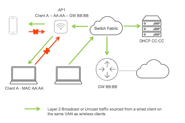

In MR 25.11 and newer, HSRP is supported. With HSRP, egress traffic uses the virtual MAC for the default gateway, but HSRP uses the physical MAC for the source MAC on ingress traffic coming back in through the gateway. With this new functionality, the AP will allow ingress traffic from upstream devices, regardless of the source MAC. This allows Client Isolation to operate in conjunction with HSRP. In the instance that ingress traffic is sourced upstream to a client (rather than return traffic) the ingress traffic will be allowed through the MR. Return traffic from the client will be filtered (since traffic is not destined for gateway).
Ingress traffic is sourced upstream to a client (rather than return traffic) the ingress traffic will be allowed through the MR. Return traffic from the client will be filtered (since traffic is not destined for gateway).

The figure below shows that broadcast or unicast traffic sourced from a wired client on the same VLAN as the client will be allowed to reach the client via the AP, but any return traffic from the client will be blocked.
