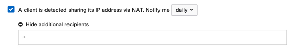

To enable NAT detection on MS switches, log into the Meraki dashboard for a network that contains MS switches and navigate to Network-wide > Configure > Alerts.
In the "Switch" section, click the check box for the "A client is detected sharing its IP address via NAT." option:
Select to be alerted ASAP, daily, or weekly, and optionally define additional alert recipients. Daily or weekly alerts may be appropriate if you find that a large amounts of alerts are generated frequently using the ASAP option.
