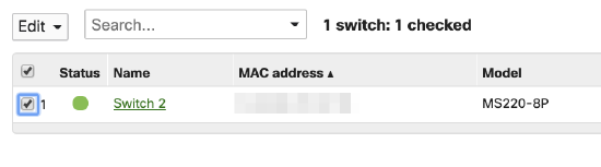

  1. Navigate to Switch > Switches and select a checkbox next to your target switch (or switches)
Clone targets selected in old version Dashboard

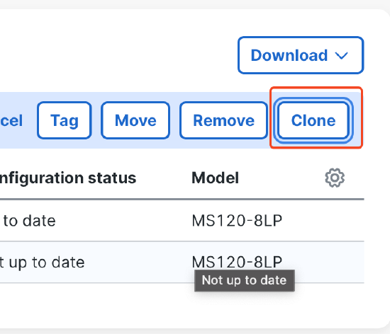

  1. Select Clone
Clone switch in New Dashboard
