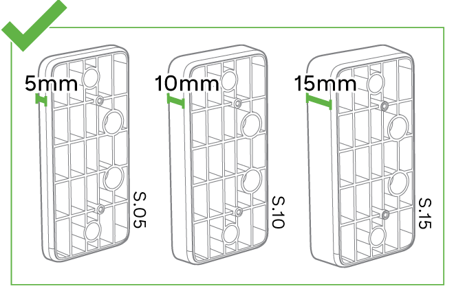

Spacers
In certain scenarios where the door doesn’t sit flush with the frame, spacers can be used to reduce the gap between the sensor body and the magnet. The box includes spacers of different thickness: 5 mm, 10 mm and 15 mm.
To install using the spacer:
  1. Use the included screws or the VHB tape to secure the spacer on the surface.
  2. Remove the battery compartment on the main sensor body and attach it to the spacers using the included screws.
Make sure the arrows on the spacers point toward the grey side of the sensor body.
