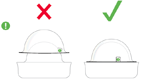

3. Turn the optical dome counter clockwise to unlock from the body and pull outward to remove.
4. Slide camera over top of mount plate and rotate onto mount plate hooks. Secure with Phillips or Torx head safety screw.

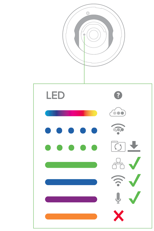

5. Observe the status LED on the left side of the camera lens assembly and ensure the camera is connected via Ethernet (solid green) or WiFi (solid blue). A MV must first be provisioned over a wired Ethernet connection before it can be deployed wirelessly. For information on how to connect via WiFi, see the setup guide here.
Your MV22 is equipped with a LED light on the front of the unit to convey information about system functionality and performance.
The various status conditions of a MV are indicated by the following colors and patterns:
- Rainbow (solid, rotating through colors) - MV is booting up.
- Flashing Blue - MV is searching for WiFi network(s).
- Flashing Green - MV is upgrading or initializing for the first time.
- Solid Green - MV is connected via Ethernet.
- Solid Blue - MV is connected via WiFi.
- Solid Violet - MV has audio recording enabled.
- Solid Amber - MV is unable to connect to Dashboard.

Do not adjust or remove the rubber lens gasket or the protective lens guard.
7. Replace optical dome and turn clockwise to lock. Remove the protective plastic cover.
