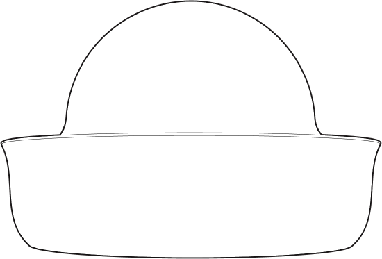

MV23 Series Overview
The Cisco Meraki MV23 series are network cameras that are easy to deploy and configure. They integrate with the Meraki Dashboard and use cloud-based edge storage. The MV series removes the need for complex servers and video recorders. This eliminates the usual limits on video surveillance setups.

Mounting Instructions
The MV23 wall mount offers a quick, simple, and flexible way to mount your device in most scenarios. Installation involves a few straightforward steps.
Leave the protective plastic cover on the optical dome throughout the installation process to prevent any damage to the dome. The protective cover should be removed once the installation is completed.
