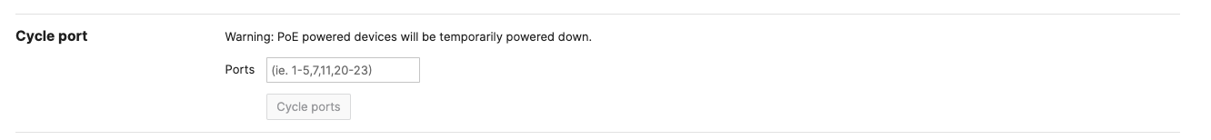

Cycle Port
This tool allows an admin to quickly disable and re-enable a switch port, multiple port numbers (separated by commas), or a range of port numbers (e.g. 1-24). PoE powered devices will be temporarily powered down. This can be useful to remotely reboot a connected PoE powered device such as a VoIP phone, or an Access Point.

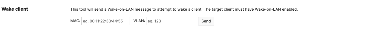

Wake Client
If a client machine has been configured with Wake-on-LAN enabled, an admin can specify that host's MAC address to send a magic packet and wake the host machine. An admin can also specify a VLAN, and broadcast a magic packet out on that VLAN. This tool can be useful in a network environment that utilizes Wake-on-LAN for remote power management.
