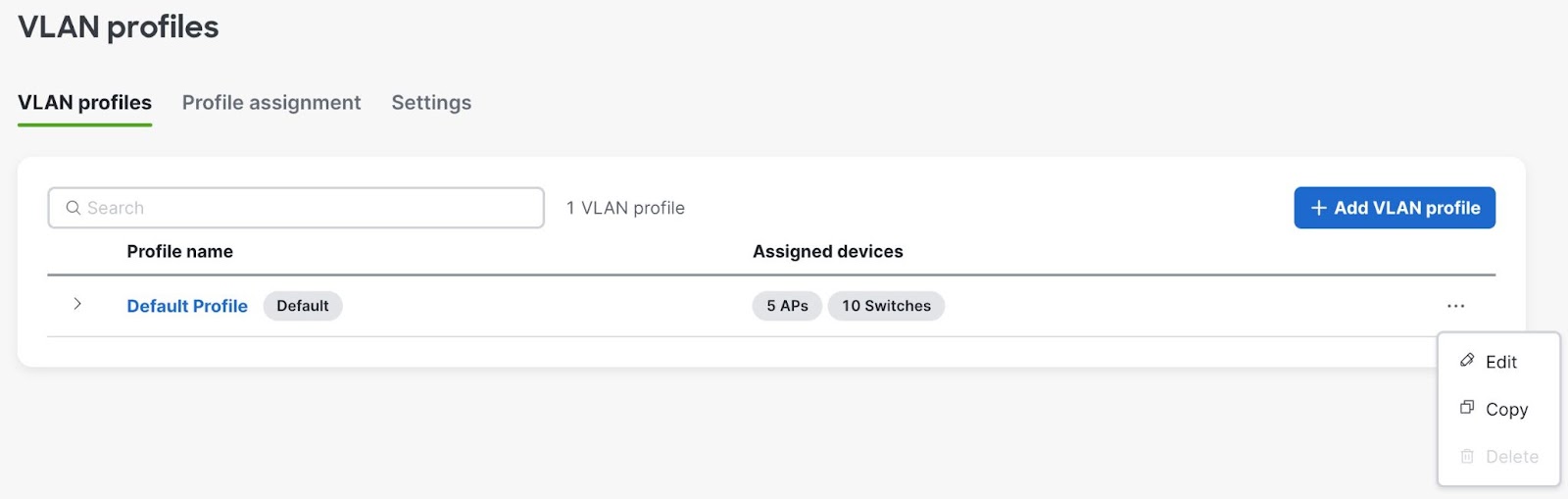

  1. Navigate to Network-wide->VLAN profiles
  2. Select VLAN Profiles Tab, Click the …  and select Edit
From the VLAN profile list click the tree dots on the right and select Edit
  • Select the VLAN you'd like to add/edit an SGT for from the drop down box, then click save profile changes
From the VLAN list add or edit the Adaptive Policy (SGT)
