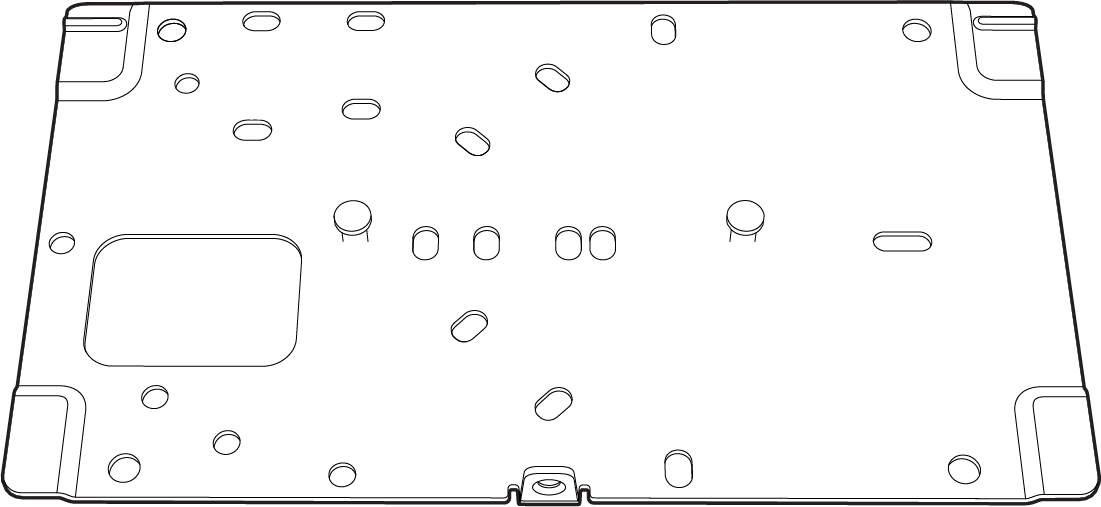

The mount plate has the following features:

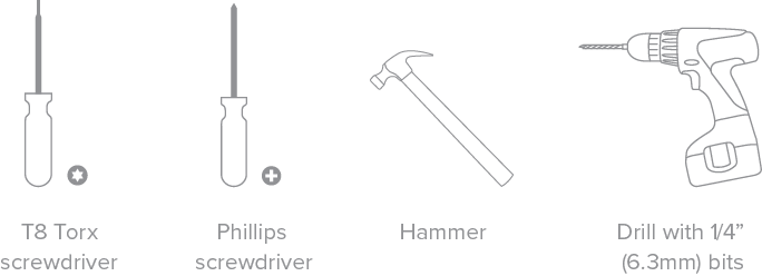

Collect Tools
You will need the following tools to perform an installation:

Attach the GR12 to the Mount Cradle
The GR12 attaches to the mount cradle with two tabs on the cradle that insert into the GR12, and is secured to the cradle using one screw.
To attach the GR12 to the mount cradle properly, line up the top edge of the AP with the top tab of the mount cradle. Since the cradle is already mounted to the wall, guide the GR12 towards the top tab and insert the top tab into the GR12’s slot.
Then adjust the GR12 to guide the GR12’s bottom slot into the cradle’s bottom tab until it clicks into place. Once in place, the GR12 should be secured to the cradle by using one of the included screws in the cradle’s bottom tab.
