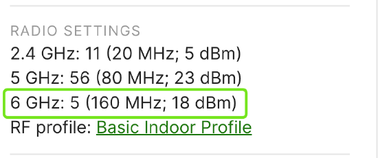

Transmit Power Levels
Please note TX power levels listed within the AP details page are the base transmit power levels of the AP’s radios and do not include the TX gain from attached antennas.
