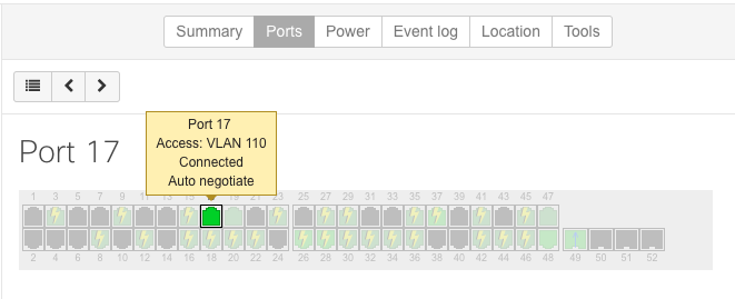

Switch front panel in Meraki Dashboard when a specific port is selected.
View details for a single port
Select a specific port to view more detail about that switch port.
