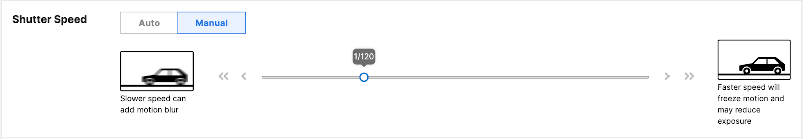

To adjust the shutter value, toggle the option to Manual. The default manual shutter speed is 1/120 seconds. This setting may not suit every situation but serves as a baseline. Changing the shutter speed in manual mode will directly affect the recorded video.
Once the Shutter is toggled to Manual, a warning is displayed, which the user needs to read & confirm.
This image is displayed to show the warning message that appears when the shutter is toggled to Manual, which the user needs to read and confirm.
Once confirmed, the manual shutter control will be visible for tuning. Hovering over the selector displays the shutter speed in seconds.
This image is displayed to show the manual shutter control interface that appears after confirmation, with the shutter speed in seconds shown when hovering over the selector.
