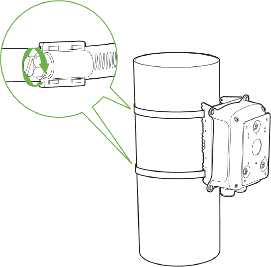

Step 2: Mount the Pole Adapter to the Pole
Wrap the Stainless Rings (Hose Clamps)
Take each stainless ring and pass it around the pole at the desired height.
Thread the free end into the clamp housing to form a loop.
Position the Pole Adapter
Align the adapter assembly (with the optional junction box ) against the pole so the stainless rings line up with the slots on the adapter’s sides.
Tighten the Clamps
Using a flathead or socket driver, turn the clamp bolt clockwise to tighten each ring.
- Ensure the bracket is vertical and the camera mounting side is facing your target viewing area.
