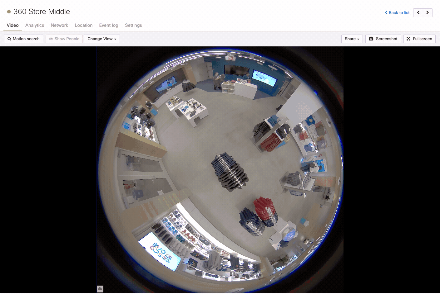

Fisheye View (warped, default view)
The MV32 shows a circular, warped, 360-degree view by default. All platforms support this view. To switch views or return to the fisheye view, click "Change View" on the bar above the feed.
This image shows the default 360-degree fisheye view from the MV32 camera, which is supported on all platforms.
