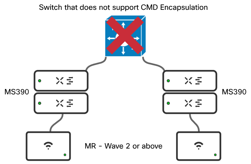

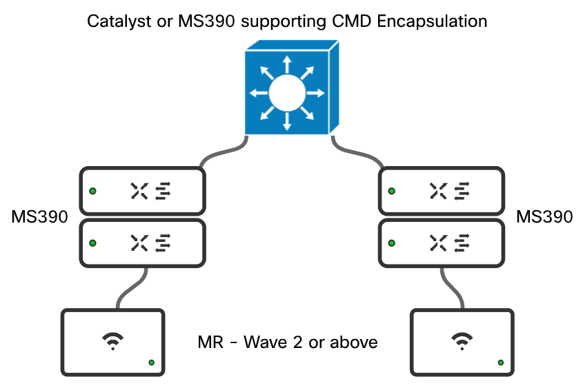

  • No transit devices in between inline SGT nodes that do NOT support inline SGTs. Inline SGTs are carried using an encapsulation called Cisco MetaData (CMD). CMD encapsulation support is an ASIC level functionality that may or may not transit a switch that does not understand the Ethertype.
  • Policy is enforced at the destination. Given this is the case, the entire path from source to destination must support CMD encapsulation through the network.
An example of a correct design is shown below:
Catalyst or MS390 topology design supporting CMD Encapsulation.
An example of a incorrect design is shown below:
Incorrect design with a switch not supporting CMD Encapsulation between sets of MS390s.

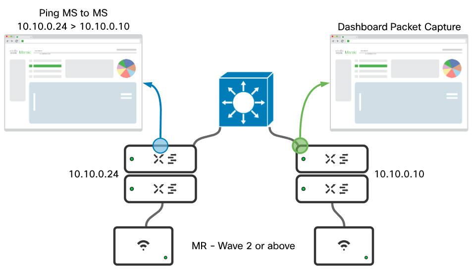

Using Meraki Dashboard Tools
A simple ping (ICMP) can be used to test and validate that tags are making it through the core device. To do this, ping through the core and perform a packet capture on the destination uplink port, as shown in the example below. Once the capture is complete inspect in Wireshark.
Example:
Diagram showing ICMP used as a testing tool for validating tags are making it through the core device.
Correct output:
PCAP filter showing the Cisco MetaData confirming a SGT tag is present.
To validate the tag has made it through the environment the follow needs to be performed in the packet capture:
  1. Select an ICMP packet with the correct source and destination IPs.
  2. Expand the Cisco MetaData field in the packet.
  3. Ensure that the tag (as highlighted above) is 2. If the tag is 0 there is a configuration error and a port by port configuration check is necessary
For a handy wireshark filter: “icmp && cmd.sgt == {sgt) && ip.addr == {source switch}”
Example: “icmp && cmd.sgt == 2 && ip.addr == 10.10.0.24”
