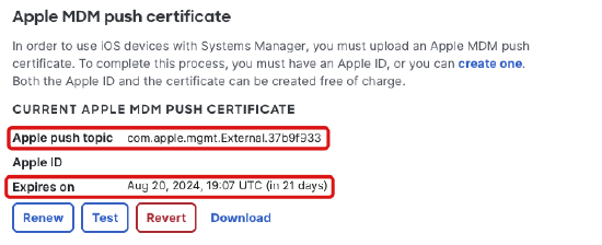

  • Navigate to the Organization > MDM page
  • Make note of the Apple push topic and the Expires on date

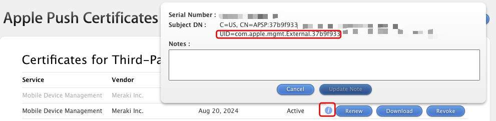

  • Navigate to the Apple Push Certificate Portal.
  • Look for any certificates with a Vendor of "Meraki Inc.".
  • Verify that the Expiration Date matches what was displayed in Dashboard.
Click the info icon  (i) to pull up the detailed information about the certificate and verify that the UID matches the Apple push topic.
