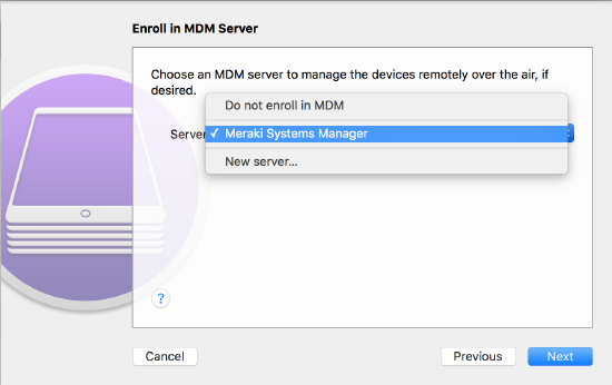

Choose Configuration: Manual. Click Next.
Choose your Meraki MDM Server (set up in Steps 1-7). Click Next.
