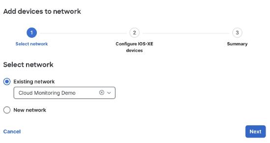

Complete the three steps to add the switch to your Dashboard network using device configuration:
You can then go back to your switch list page by selecting Switching > Switches from the left-side navigation and confirm the switch was added with device configuration.
