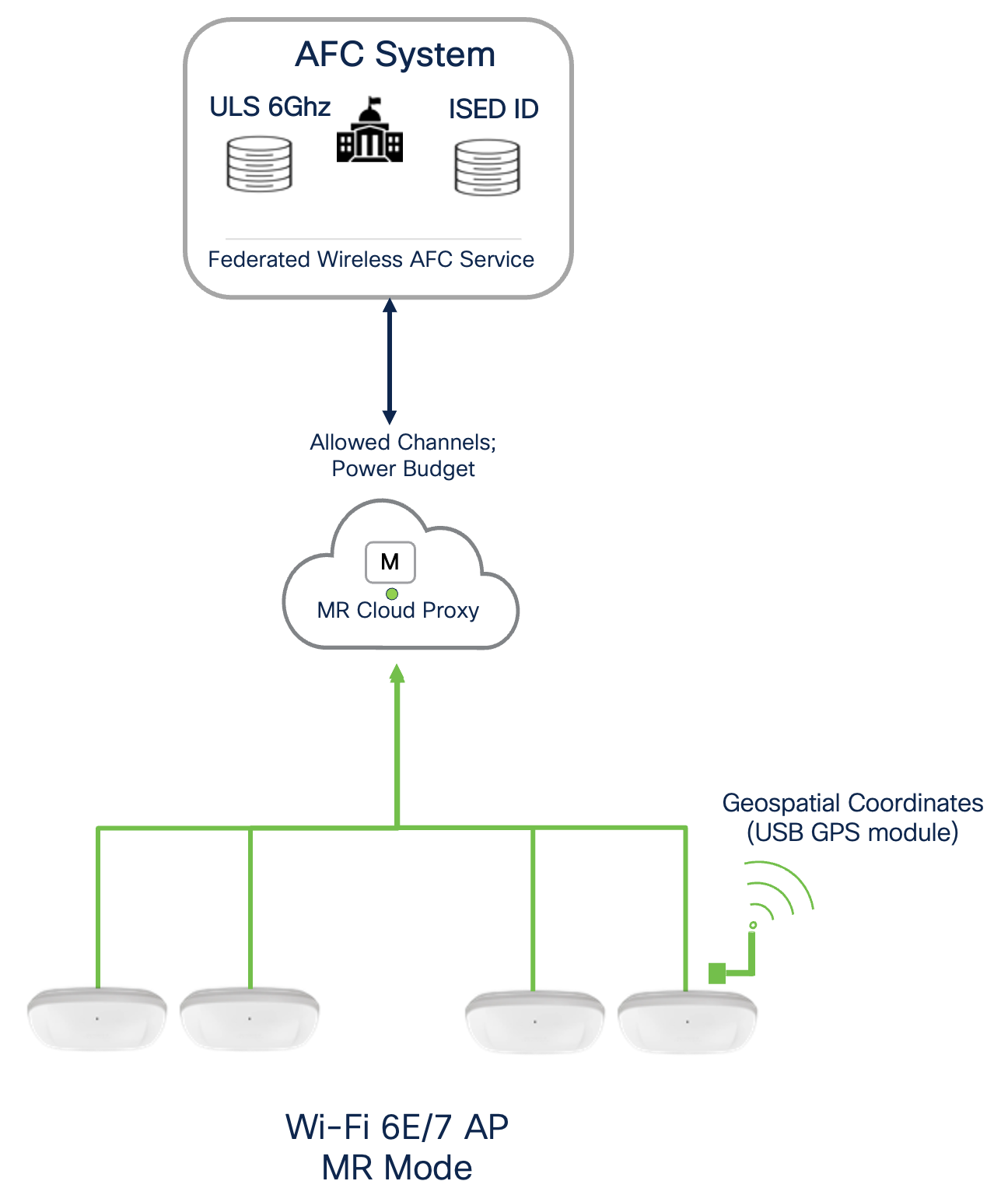

AFC Operation
Automated Frequency Coordination System is a cloud-based operator (Example: Federated Wireless, Open AFC) that has access to regulatory domain specific 6 GHz, incumbent database, which stores geolocation coordinates and power of these licensed wireless services operating in the 6 GHz spectrum. In order to avoid interference the access point must present its geolocation coordinates to the AFC provider when powering on and before powering on the 6 GHz radio.
For cloud-based deployments, dashboard will serve as a proxy to the AP by requesting location information to pass to the AFC provider (Federated Wireless). Upon receiving the request, the AFC provider will query its database to see if there is an overlap of a licensed 6 GHz service in that geolocation.  Based on its computed results, the AFC will send a response to the Dashboard on the channels and the power levels the AP can operate at.
AutoRF in Dashboard will then use this information to set the correct transmit power for channels for the AP. Dashboard administrators can also choose channels with knowledge of what power limits the channels have been provided by AFC. For every access point transmitting in the 6 GHz band at Standard power will need to have its AFC data refreshed once a day (every 24 hours) to stay in compliance.

AP Geolocation
As per regulation,  APs operating at Standard Power must automatically obtain geolocation coordinates using an external or internal GPS module. To automatically obtain the geolocation of an access point, Cisco Wireless has developed the CW-ACC-GPS1.  A GPS module that attaches to the USB port of select MR and CW model access points. Once installed, position the access point on the floor of a building near a window with a clear line of sight to the sky. The GPS module will then be able to acquire a satellite signal and share the AP's location with dashboard.
The mounting height of the AP is a necessary parameter, this measurement does not have to be auto-generated and can be manually entered in dashboard with a given range of uncertainty.

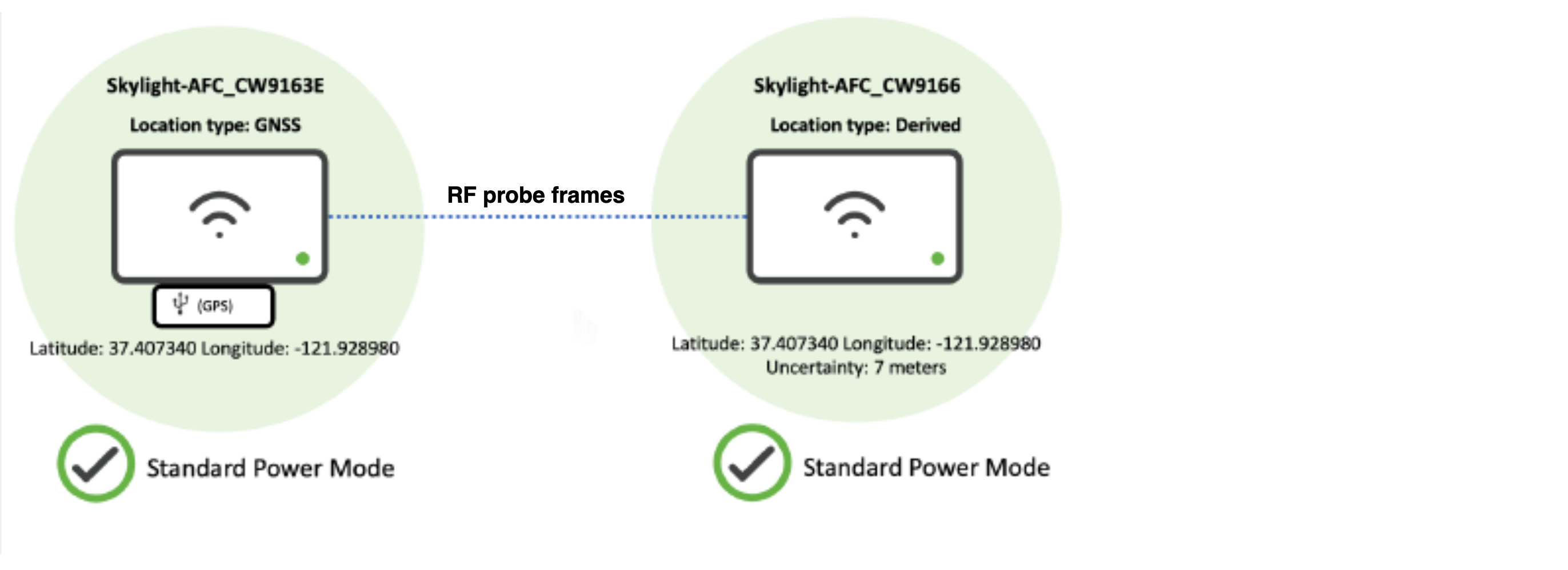

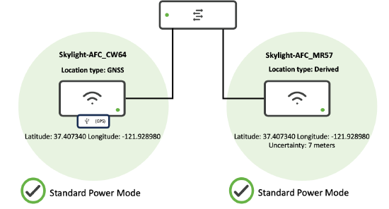

Geolocation Propagation
Access points enabled for Standard Power do not need an embedded or USB-attached GPS module. If at least one nearby access point has a valid GPS signal, other neighboring access points can leverage the same GPS coordinates with a relative measure of uncertainty. This process is known as geolocation propagation and can be accomplished either through wired proximity on the same layer 2 switch stack or share RF neighborship up to a calculated distance of up to 200 meters from an AP with a valid GPS signal.
In the two scenarios below, a location algorithm determines the relative position of the access point with a derived GPS location to the access point with a GPS module reporting GPS coordinates to dashboard (anchor AP).
Neighboring AP is able to see an anchor AP as its neighbor and can hear beacon frames on any band/ radio.
Neighboring AP is connected to the same dashboard-managed switch or switch stack as an anchor AP with the GPS module.

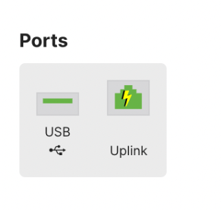

  1. Insert the GPS module into the USB port of the access point.
  2. The USB port is configurable from the Wireless > Configure > Port Profiles page. For example the MR57, CW9166/64/62 will have USB labeled as a configurable port.
  3. Create a new port profile.
  4. Enable USB port.
  5. Assign the profile to AP.
  6. Ensure the USB port is receiving power via dashboard.

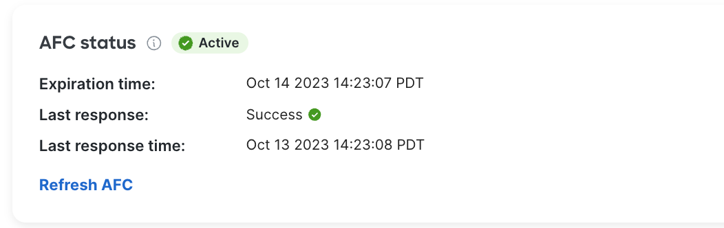

Verify AFC Status
Verify AFC status
  1. Navigate to the Access Point list, and select an AP that is now enabled for AFC.
  2. From the AP’s overview page, select the AFC tab.
AFC Status
AFC status information
The AFC overview page shows the current AFC status of an AP. A status of active means a successful request to the AFC provider along with the associated response. The AFC status page includes the target expiration time at which the current AFC response expires. Per regulation, every AP operating in 6 GHz, AFC status needs to be refreshed once a day (every 24 hours).

AFC Defined AP Location
The Location type specifies how the AP’s geographical location is determined.
If an AP has a GPS module either internally or externally and it has acquired a signal from a satellite, the Location type will indicate "GNSS" (Global Navigation Satellite System), along with the latitude and longitude coordinates of the AP. This indicates that the GPS module has recorded the positioning of the AP locally,
Global Navigation Satellite System (GNSS) refers to a constellation of satellites providing signals from space that transmit positioning and timing data to GNSS receivers. The receivers then use this data to determine location.
If the location type is reported as "Derived" it means that the location was not obtained locally via a GPS module, but rather through wired or wireless geolocation propagation with a neighboring AP.
If the Location type is empty, AFC operation is not allowed or otherwise impossible as neither GPS nor wired/wireless propagation was successful or invoked (i.e., if AFC is disabled, no valid GPS signal, the USB port is down, etc.).
After the AP powers up (or) the USB port registers as enabled, wait 10 minutes for the AP to obtain a GPS signal. If the GPS module can get a satellite signal, the location will be automatically populated with the source as “GNSS".
APs that have their location "Derived" share the same geographical coordinates as the neighbor AP with a satellite signal. Dashboard provides an estimate of the distance between the APs with a level of uncertainty. This uncertainty level is passed to the AFC provider, which regulates a lower power allowance for the derived AP to operate.

AFC Refresh
POST /devices/{serial}/wireless/radio/afc/refresh
Queues the AP for an AFC refresh to override the 22 hour refresh

AFC Status
GET /devices/{serial}/wireless/radio/afc/powerLimits
GET /organizations/{organizationId}/wireless/radio/afc/powerLimits/byDevice
Get status of most recent AFC response for device or for whole organization (can filter with list of network IDs)
