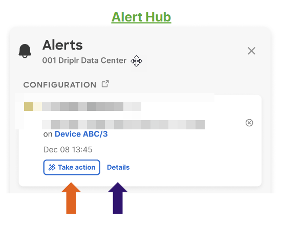

You can start the RCA process from three entry points:
  • The Alert Hub
  • The Device Details Page
  • The Organization Alerts Page
Use either the Alert Details or Take Action link or button to open the RCA side drawer workflow. These examples show where you can begin RCA troubleshooting in the dashboard.
  The image is displayed to illustrate the three entry points—Alert Hub, Device Details Page, and Organization Alerts Page—where users can begin the Root Cause Analysis (RCA) troubleshooting workflow in the Dashboard, with Alert Details and Take Action links/buttons leading into the RCA side drawer workflow. This demonstrates the generic locations within the Dashboard to start the RCA process.
Entering the RCA workflow opens a side drawer that guides you through steps for the specific alert. Below the alert title, you will see two tabs: Alert Details and Suggested Actions. Your starting section depends on the link or button you selected. You can switch between tabs at any time. Each RCA contains product and alert-specific content, but the overall layout stays consistent.
 The image is displayed to illustrate the RCA workflow side drawer that opens upon entering the process, showing the two tabs—Alert Details and Suggested Actions—below the alert title, which guide users through a curated, product-specific troubleshooting experience while allowing navigation between these sections freely       The image is displayed to illustrate the RCA workflow side drawer that opens upon entering the process, showing the two tabs—Alert Details and Suggested Actions—below the alert title, which guide users through a curated, product-specific troubleshooting experience while allowing navigation between these sections freely

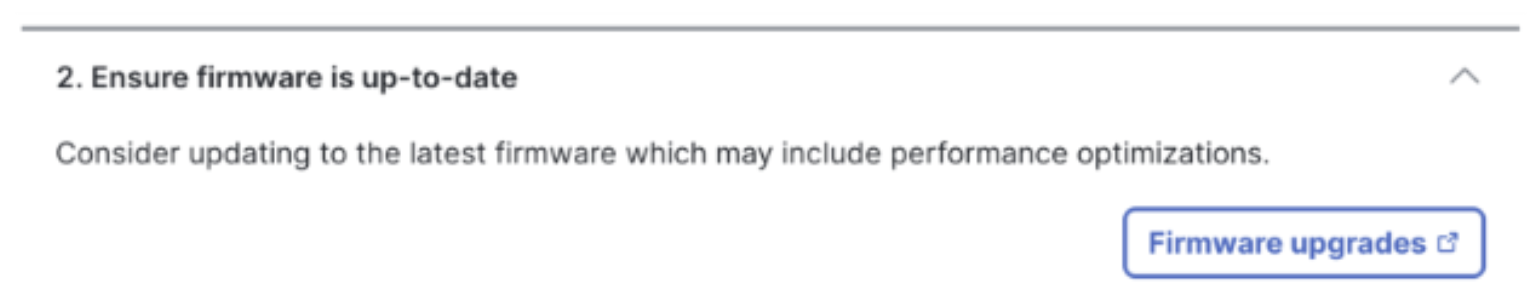

  1. Ensure firmware is up-to-date
 This image is displayed to remind users to ensure their device firmware is up-to-date for optimal functionality and security.
