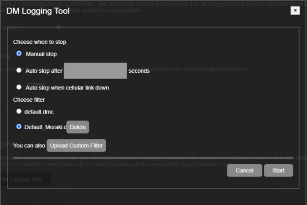

DM logging on the local status page
Integrated Diagnostic Monitor (DM) logging debugs cellular WAN interface issues on the MG41 and MG51. The DM logs contain northbound Long Term Evolution (LTE) and Universal Mobile Telecommunications System (UMTS) messages exchanged between the modem and the service provider's cellular network. DM logs help determine whether a problem originates on the MG41 or MG51 or within the service provider network.
Launch the DM logging tool from the Configure tab on the local status page.
If there are persistent issues with the cellular WAN, engage Meraki Support for further troubleshooting assistance.

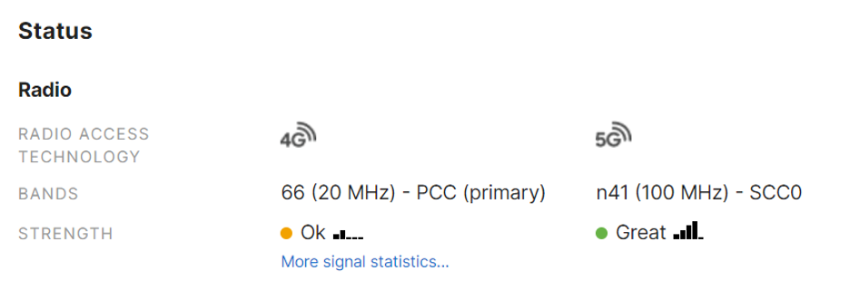

Viewing radio status on the dashboard
View radio status in the Uplink tab of the MG status page on the dashboard. For the MG51, the radio status section displays both current 4G and 5G radio status, including current bands and signal strength.
When the MG establishes a 5G connection, the radio status displays both the 4G LTE and 5G NSA radio status.
