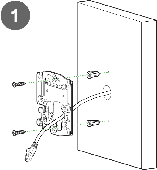

Mounting Instructions
Step 1 mounting instructions. Picture includes indicators of where 2 screws should be positioned when screwing the mounting plate and wall.
Step 2 mounting instructions. Picture shows the power source can be an USB C cable versus a PoE ethernet cable.
Step 3 mounting instructions. There is an arrow which indicates how to attach the MT15 into the mounting plate.
Step 4 mounting instructions. MT15 is shown to be connected to the mounting plate.
For most mounting scenarios, the MT15 has flexible options to provide quick and simple mounting. The instructions are as follows:
NOTE - It is important to ensure that the sensor is oriented in the correct position for the data collected to be accurate.
  1. In order to mount the sensor on different locations, there are 2 supported orientations
    1. Wall - The mounting plate can be directly screwed onto the wall (Option B) or on a Junction Box.
    2. Ceiling - The device can be mounted on a ceiling using the included screws, or by using a T Rail mount (Not included) (Option C), or on a Junction Box (Option A).
