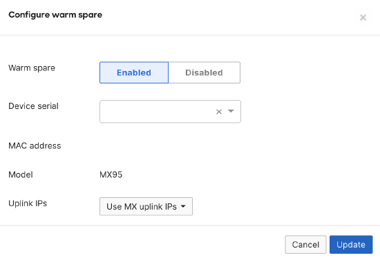

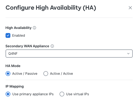

To configure warm spare failover for an existing dashboard network, navigate to the Security & SD-WAN > Monitor > Appliance status and select Configure warm spare near the upper-left side of the page, below the device name. In the window that appears, select Enabled. Enter the serial number of the secondary MX and select the desired uplink IP configuration, then select Update to enable warm spare.
Configure warm spare button on the Appliance status page.
Configure Warm Spare Settings Window
Adding or replacing an online/offline spare MX in the dashboard network will cause a brief connectivity loss on the primary MX due to the initialization of the HA configuration.
Furthermore, when a warm spare is added to a network, you will lose the ability to use VLAN objects. Any existing L3 rules utilizing VLAN objects will be removed as VLAN objects are not compatible with Warm Spare.
Use MX uplink IPs: When using this option, the current active MX will use its distinct uplink IP or IPs when sending traffic out to the internet. This option does not require additional public IPs for internet-facing MXs, but also results in more disruptive failover. This is because the IP of the outbound flows on the MX will change, which will result in a need for clients to reestablish all live sessions (e.g. web pages, applications, etc).
Use virtual uplink IPs: When using this option, both MXs will use a shared virtual IP (VIP) when sending traffic to the internet. This option requires an additional public IP per uplink, but allows for more seamless failover. This is because the IP address of the outbound flows on the MX will not change, meaning that during the failover client devices will not need to reestablish active sessions. The VIP for each uplink must be in the same subnet as the IPs of the MXs themselves. Also, the VIP must be different from both MX uplink IPs.
Regardless of which option is selected, both MX devices will need their own uplink IP addresses for dashboard connectivity.
