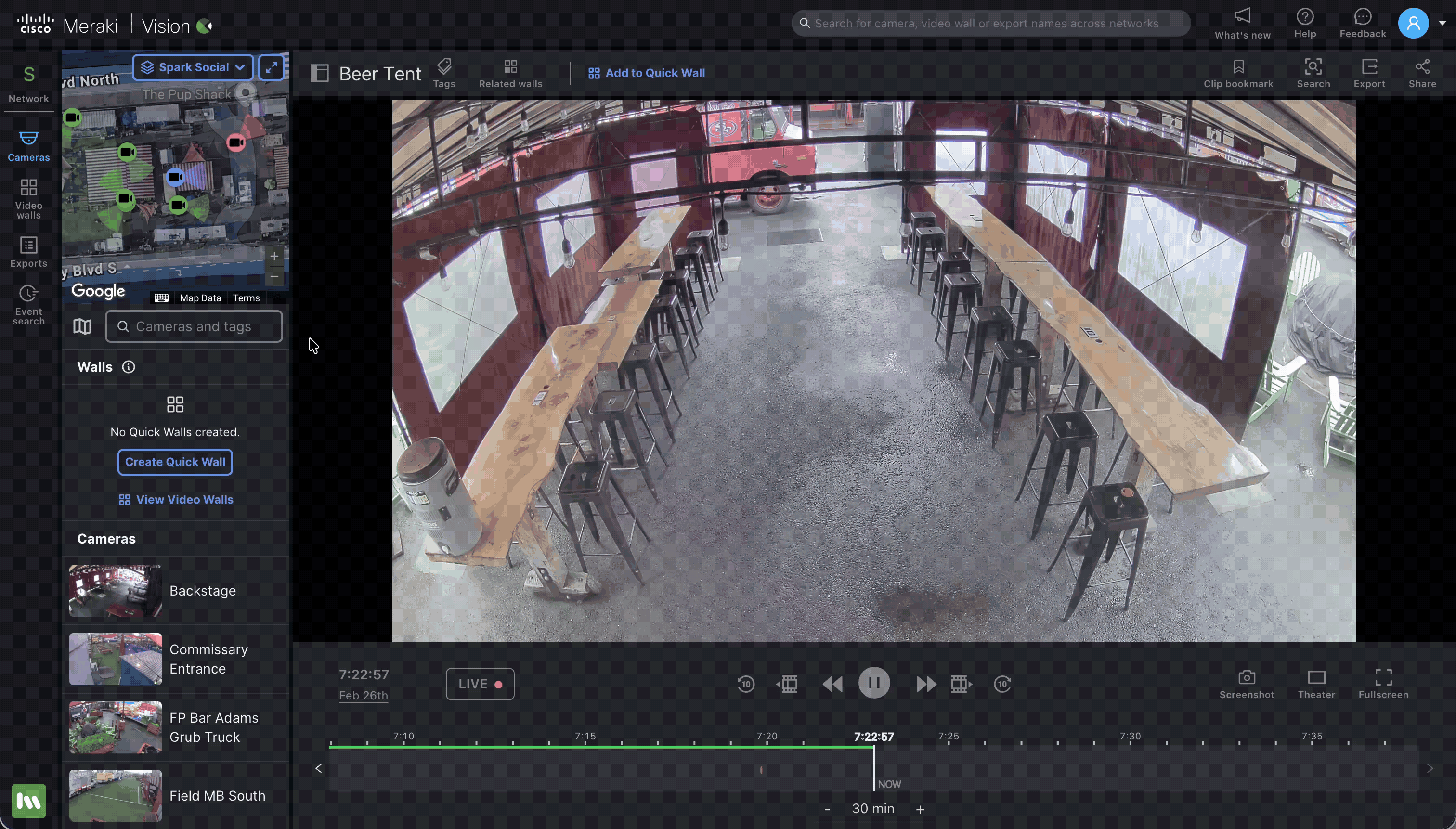

  2. Switching between maps and floor plans
    • By default, the map shows all of the cameras placed on a map.
    • If you have multiple maps and floor plans, you're able to use the switcher to select different floor plans or map.
    • The selected floor plan will be displayed as the title of the network switcher, and will only show the cameras placed on that floor plan.

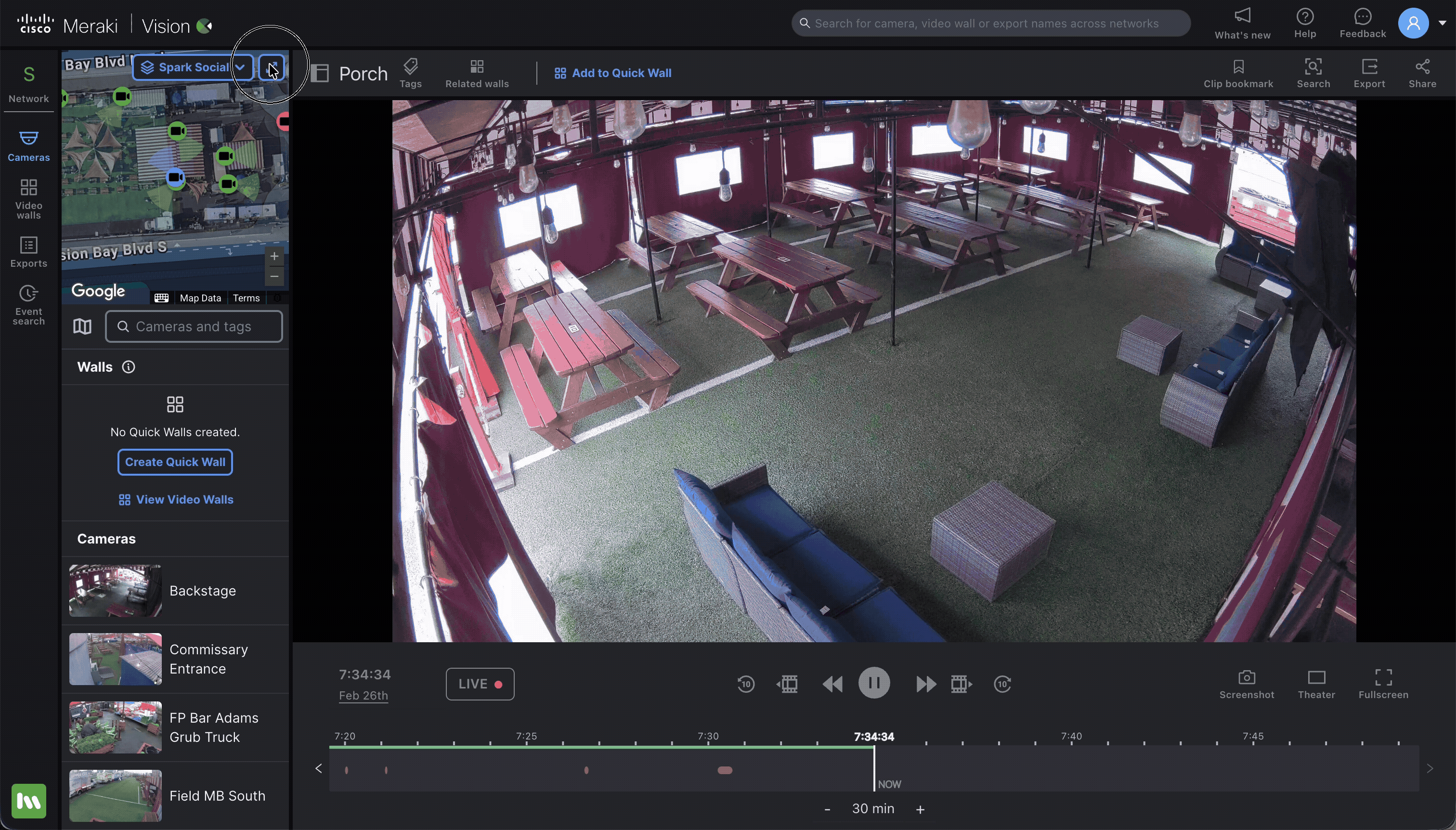

  4. Click directly on a Camera Icon to highlight it.
    • A small preview (a static image captured from your camera) will appear, allowing you to jump straight to the Live Feed, or you can switch to the floor plan associated to that camera.​​​​​​
